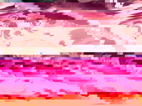

I have a 1975 TE31 with a 2T-C engine from California. It has the Golfball pistons. They are indeed 9.0:1 compression.
Golfball Piston
Golfball Piston

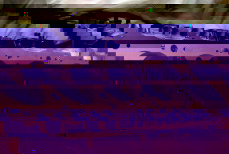

The people who previously worked on the engine did a terrible job. It looked like they used a wire brush to clear the gasket before and made a right mess of it. As a result, the head gasket had blown, the surface of the head was all scratched up, and the valves were messed up. You can see what a mess the bottom of the engine looks like in this picture:
2T-C engine
2T-C engine

I had previously heard about these pistons, so it was neat to take the head off and actually see them.
