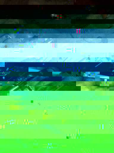

Actually the mazda can be filled by the shifter but it will take too long as the space for the thick fluid is very small.
Re: Adding Gear Oil Through the Shifter?
There's no hell way to do that don't ask me why
The shaft is solid and sealed what slide in the tube and the gravity not gone work
- Attachments
- cced8f4b.jpg (75.9 KiB) Viewed 12266 times
- c42ad60b.jpg (76.67 KiB) Viewed 12266 times

What is sealed is the outer sleeve in front and in the back, but the shifter rod itself runs free inside it, it is very close but yeah it does go down thru it, i have done it before, but i wont do it again, it takes too long!
