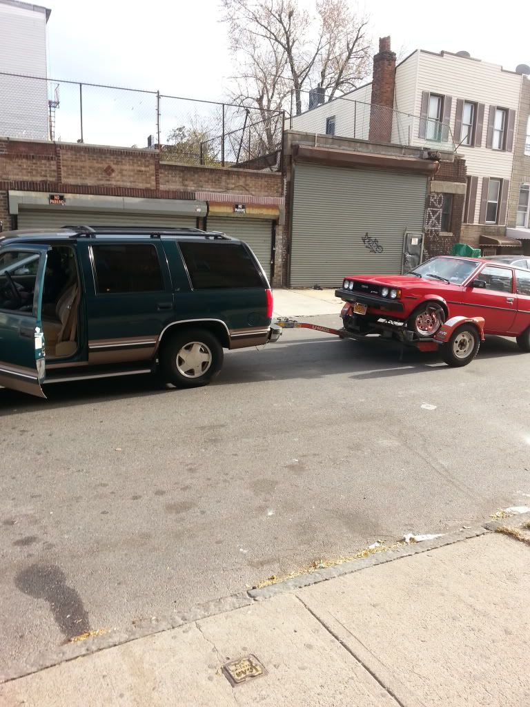

well TateQuieto is at the doctor :( so tomorrow gonna run some test on it and see whats causing the illness lol :lol: hope its just a simple cold
