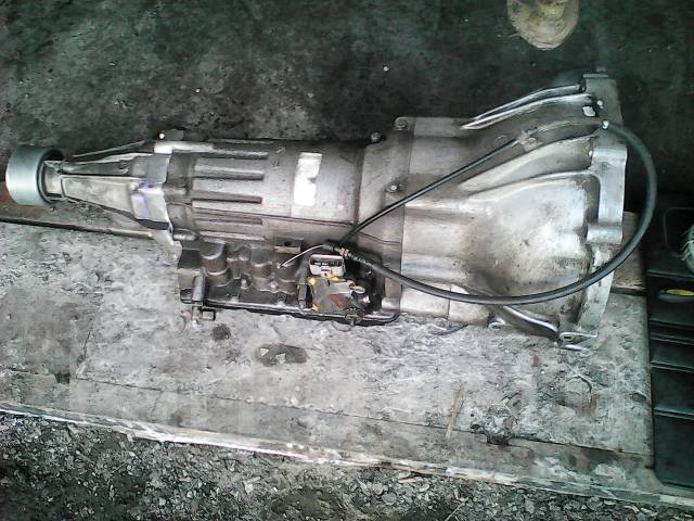

Haven't had the time to remove the bellhousings, but here's pics of both trannys...
First, the A42DL:
And, The A40:
The A42dl is longer overall and the bellhousings are a bit different... Not sure about this...

Hi, I tried to swap an A42 into my old Celica years ago. As I recall I could not put the A40 bell housing on because that extra length in the spA42 bell goes over a case extension of some sorts. You would have to get the proper bell housing for your engine to make it work. I don't know if the A 42 ever came behind a T series engine.

I found an A40-D trans. it needs rebuilding...but a friend of mine is trying a different approach, He's building a custom adapter using the stock A40 bellhousing with the extension part of the A42-DL welded on to it... so far everything is lining up...
